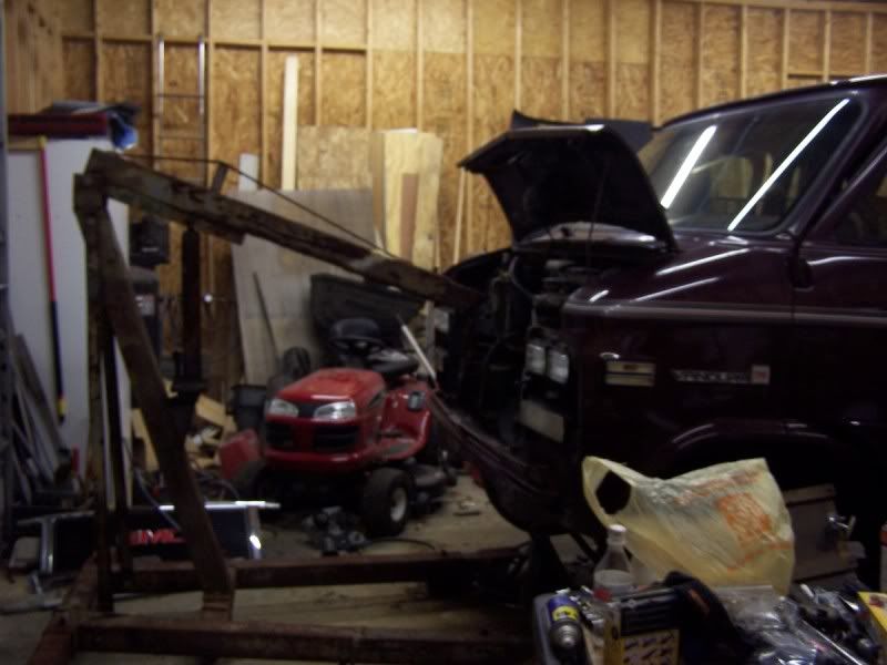

here is a 4.3 coming out of one with the intake in place...
my engine crane is bigger than a normal one.Putting the van up on stands is very help full.
No hook the bar the chain is attached to with a longer chain going across the bar to opposite heads
Mean Like This? It does'nt exactly show what happened, but from the sound of it, I may wanna wait to paint afterwards.
