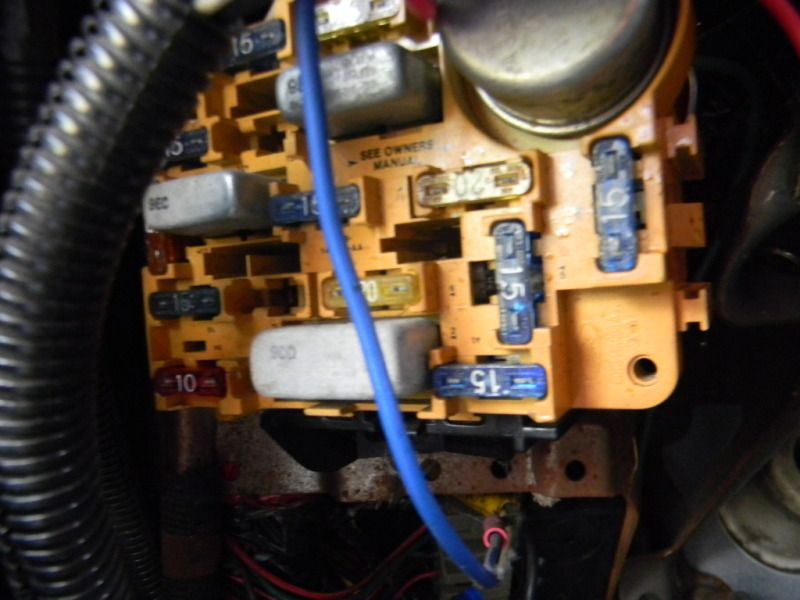

Leaving Beverly beach camp Sunday morning I realized my power seat was not working.I guessed it was just a fuse and deal with it when I got home.Every thing else was working.Dash lights,head lights brake lights radio etc.On the way home when it started to get dark I tried to turn on the mood lights.Thats when I realized the interior lights were also not working.(only the vans conversion lights) The Ford factory interior lights still work.I checked all my fuse's and don't see any bad ones.What are the silver ones in the panel? Does any one know where I should look next? Maybe a hidden inline fuse in the over head?

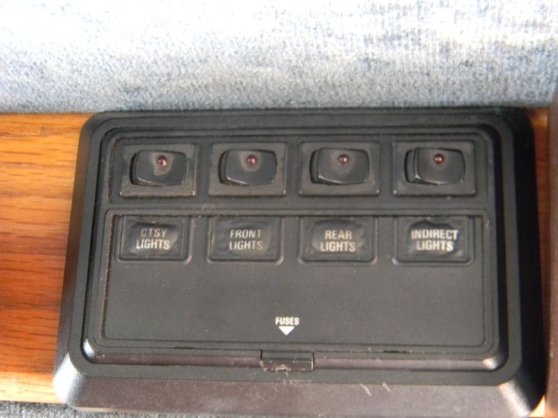

Switch panel

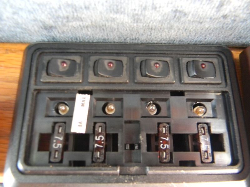

These all looked good
These lights & the rope lights dont work.They are controlled by the switches in the 1st pic.
These sliver interior lights DO WORK.

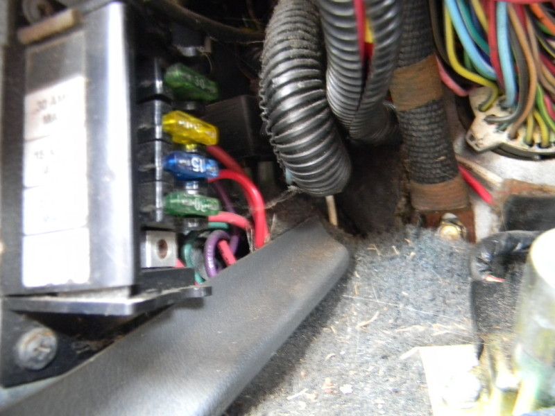

All looked good here,but not sure what the big sliver ones are?

Big silver ones are circuit breakers. Have you verified that you have power going to the fuses for the switches? Sometimes the accessory (+) feed isn't the most secure connection. On my 89 Ford Explorer brand conversion, some of the feeds for the accessories are pretty cheesy. I accidentally knock them out of the fuse box from time to time.

Get a decent volt meter and start tracing it down. Start at the light socket and work forward. Could be a bad connection or bad contact at the switch. It's not too bad to check it out. Just take your time and you will be operational again.
